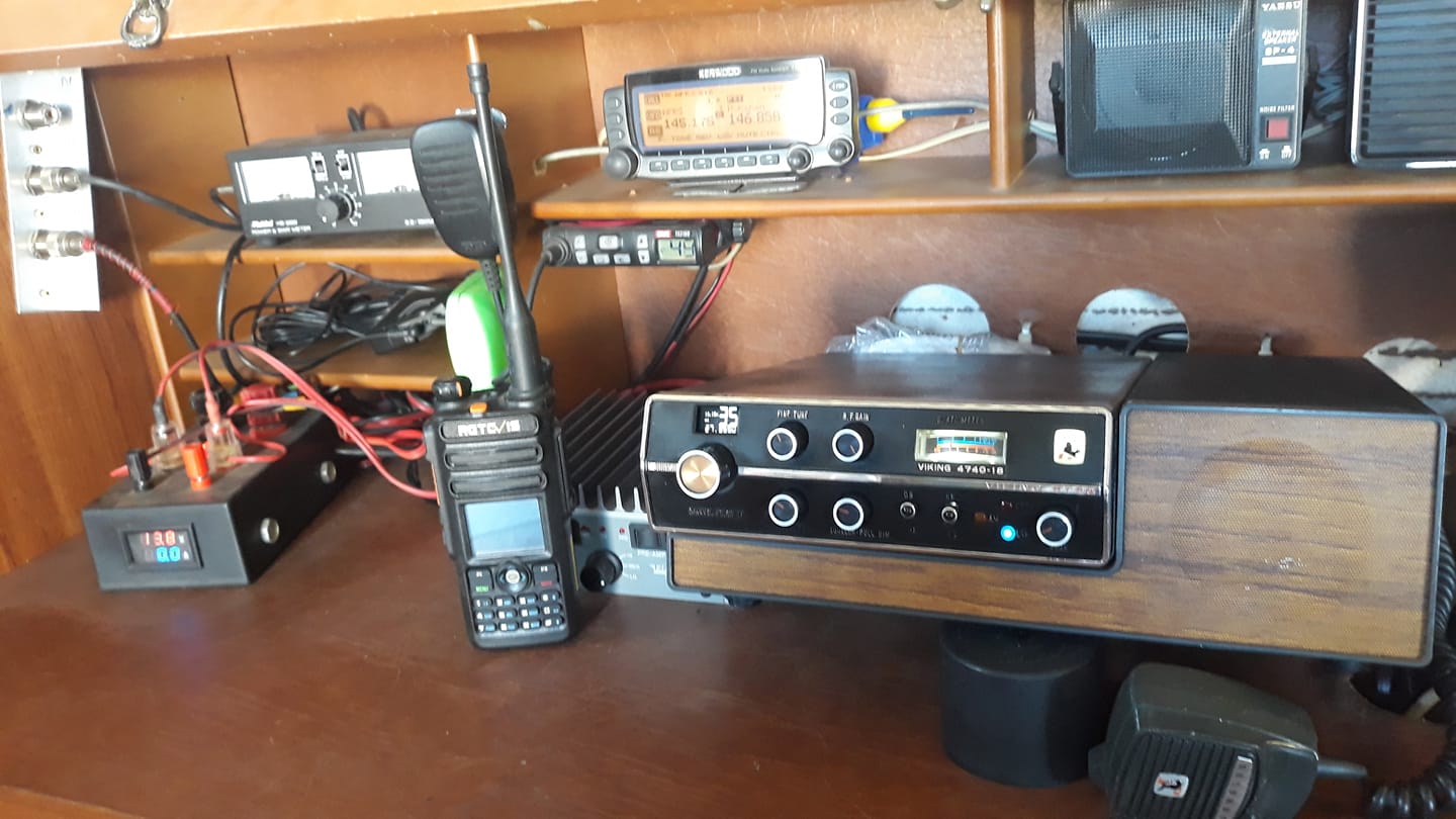

#407398
Post by davehowe »
Always loved the Johnson Viking, mine was an 18 channel and not working, nothing was left to chance with the full and might I ad, expensive rebuild. The base console is as rare as rocking horse **Censored** and easily converted to 240v
Image[mod=Bozo] added image BBcode around image url for you[/mod]
Dad0850
2 PILL USER
2 PILL USER
Posts: 10
Joined: February 14th, 2021, 10:57 am
Handle: Quadrajet
Real Name: Randy
#407400
Post by Dad0850 »
WOW! That's good to hear! I have the same console!!
