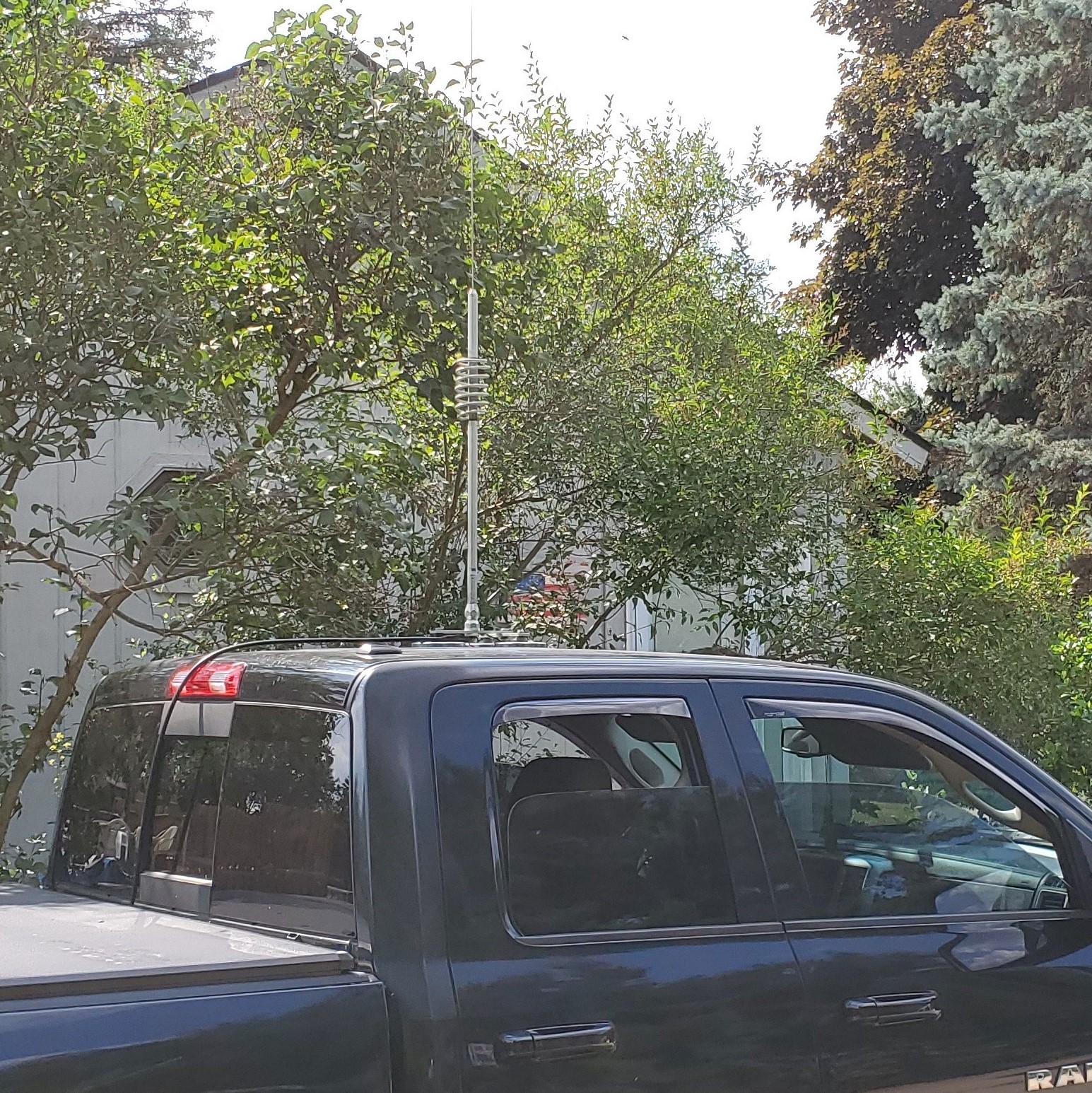

- Gunner357
- Donor
- Posts: 332
- Joined: July 5th, 2020, 6:36 pm
- Handle: Gunner357
- Real Name: Rick
- Call Sign: KE8PSI
- Antenna: Preditor 10k, V58 Maco base,EFHW-8010 end fed
- Radio: Yaesu FT920,Galaxy 88hl, Galaxy 99v, Cobra148gtl modded, Cobra 29ltd chrome
- Contact:
I vote P10KBeachbum24 wrote: September 28th, 2019, 10:27 am How about something like a Predator 10k. Make sure you check out are sponsors for the best price. And maybe you could match that with a nice KL-203 amp. Just a thought

Heres my Ram its only a peanut Ram wish I had My 2500 diesel back
