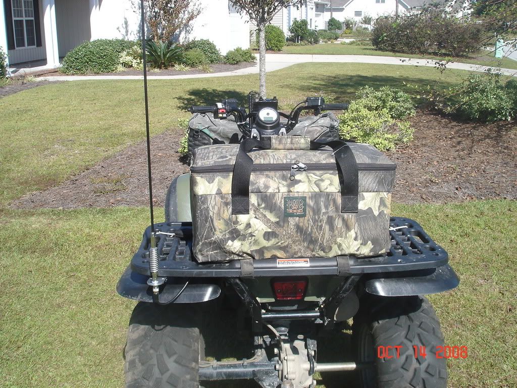

Just finished the install. swr's 1.1~~1.3 across the dial with a 102". The firestick was bad...pegged the meter when I keyed up. Yamaha Grizzly has an eye hole on the right side of the rear cargo rack. I shined it up to bare metal and tighened down a heavy duty spring. I will be using firestick type 4 footer...102 flings around too much.

Thinking about mounting it to a piece of 2x6 and then secure the wood to the rack...don't want it to be too permanent.

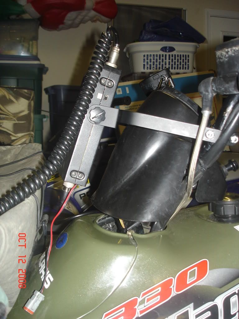

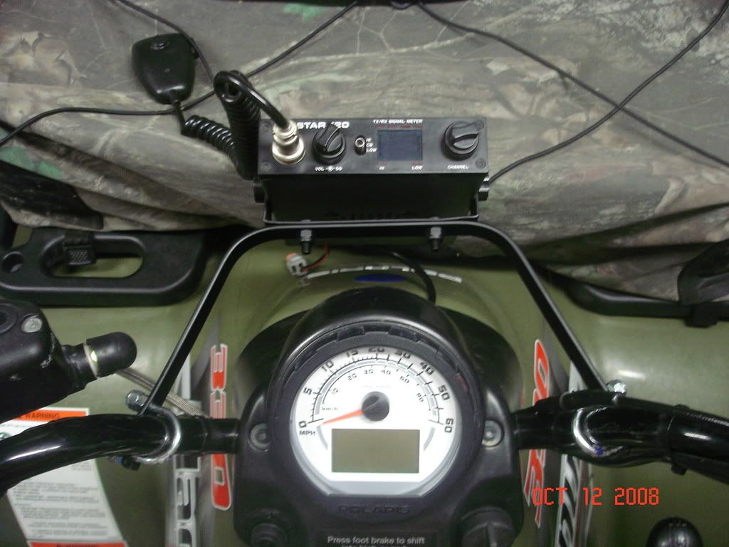

That looks like the way to go, I never thought about a handlebar bracket :oops: I'll make one tonight...I got everything hooked up with the radio mounted on the back rack...swr's 1:1 with 102", 1.2:1 with firestick...put 5db on the camp base 4mi away!!!thanks for the info RDD
